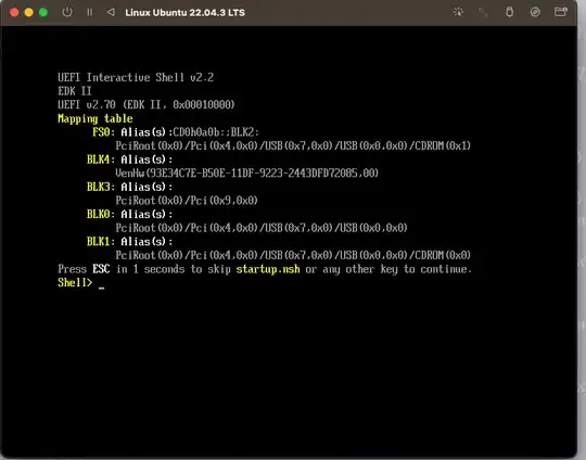

I am trying to run Ubuntu as a VM using UTM. I have successfully set everything up, however, when I should be promtet with "Install Ubuntu" or "Try Ubuntu" I get this:

Are you sure you have the correct image for your PC? Seeing that you are using the Macbook Pro with M2 chip you need to download the arm64 version of the 22.04.3 distro. So: I recommend you checking what you downloaded, and use the 22.04.3-arm64 version.
Here is also a nice article describing the process using a Macbook with M1 chip (which has the same architecture (ARM) as you do on your M2), so it will be the same, just that the article uses the 22.04-arm64.
