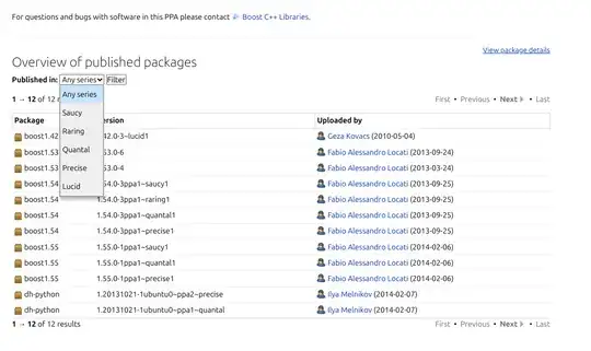

In the future, you should search Google the PPA (google "ppa:boost-latest/ppa" for example) and one of the first results should be the launchpad page.
Visit the launchpad page before you install the PPA. Then, scroll down to the Overview of published packages section and click on the dropdown menu for Published in: Any Series (see screenshot below). This will display all supported Ubuntu versions. If you do not see your Ubuntu version listed, like Focal for 20.04 or Jammy for 22.04, then you cannot use the PPA as your version is not supported.
screenshot of the launchpad page and the dropdown menu for Published in shows saucy raring quantail and a few others but there are no newer, currently supported versions of ubuntu are listed
