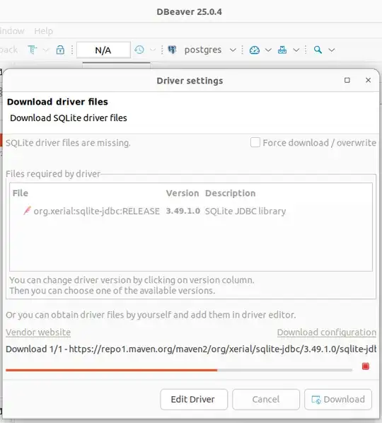

Install DBBeaver for Ubuntu (22.04)
Open the SQLite file directly using DBBeaver from File -> Open (widen the extension filter).
You'll need an additional driver, which DBBeaver detects automatically: enter image description here
