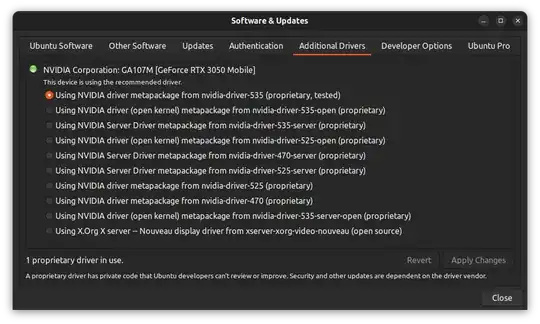

I figured it out. I installed the nvidia drivers via the "Additional Drivers" on that day :
... and in the /var/log/apt/history.log, it shows it that these non-generic kernels were also installed:
Install: linux-signatures-nvidia-5.15.0-1041-oracle:amd64 (5.15.0-1041.47, automatic), linux-objects-nvidia-525-5.15.0-1041-oracle:amd64 (5.15.0-1041.47, automatic), linux-image-5.15.0-1042-azure:amd64 (5.15.0-1042.49, automatic), libnvidia-common-535:amd64 (535.86.05-0ubuntu0.22.04.1, automatic), linux-objects-nvidia-525-6.2.0-1003-nvidia:amd64 (6.2.0-1003.3~22.04.1+2, automatic), linux-image-5.19.0-1027-oracle:amd64 (5.19.0-1027.30, automatic), libnvidia-fbc1-535:amd64 (535.86.05-0ubuntu0.22.04.1, automatic), libnvidia-fbc1-535:i386 (535.86.05-0ubuntu0.22.04.1, automatic), linux-signatures-nvidia-6.2.0-1010-aws:amd64 (6.2.0-1010.10~22.04.1, automatic), linux-image-6.2.0-1011-lowlatency:amd64 (6.2.0-1011.11~22.04.1, automatic), linux-modules-5.15.0-82-lowlatency:amd64 (5.15.0-82.91, automatic), linux-modules-5.17.0-1035-oem:amd64 (5.17.0-1035.36, automatic), libnvidia-gl-535:amd64 (535.86.05-0ubuntu0.22.04.1, automatic), libnvidia-gl-535:i386 (535.86.05-0ubuntu0.22.04.1, automatic), linux-image-5.15.0-1038-intel-iotg:amd64 (5.15.0-1038.43, automatic), linux-modules-5.19.0-1014-nvidia-lowlatency:amd64 (5.19.0-1014.14, automatic), linux-signatures-nvidia-6.2.0-1011-lowlatency:amd64 (6.2.0-1011.11~22.04.1, automatic), linux-signatures-nvidia-5.19.0-1014-nvidia-lowlatency:amd64 (5.19.0-1014.14, automatic), linux-signatures-nvidia-5.19.0-1010-nvidia-lowlatency:amd64 (5.19.0-1010.10, automatic), libnvidia-extra-535:amd64 (535.86.05-0ubuntu0.22.04.1, automatic), nvidia-compute-utils-535:amd64 (535.86.05-0ubuntu0.22.04.1, automatic), nvidia-driver-535:amd64 (535.86.05-0ubuntu0.22.04.1), linux-signatures-nvidia-6.2.0-1012-gcp:amd64 (6.2.0-1012.12~22.04.1, automatic), linux-modules-6.2.0-1008-azure:amd64 (6.2.0-1008.8~22.04.1, automatic), dctrl-tools:amd64 (2.24-3build2, automatic), linux-image-5.19.0-1014-nvidia-lowlatency:amd64 (5.19.0-1014.14, automatic), linux-image-5.19.0-1010-nvidia-lowlatency:amd64 (5.19.0-1010.10, automatic), linux-image-5.15.0-1031-nvidia:amd64 (5.15.0-1031.31, automatic), linux-signatures-nvidia-5.15.0-1045-azure:amd64 (5.15.0-1045.52, automatic), linux-image-5.15.0-82-lowlatency:amd64 (5.15.0-82.91, automatic), libnvidia-encode-535:amd64 (535.86.05-0ubuntu0.22.04.1, automatic), libnvidia-encode-535:i386 (535.86.05-0ubuntu0.22.04.1, automatic), linux-signatures-nvidia-5.19.0-1014-nvidia:amd64 (5.19.0-1014.14, automatic), linux-objects-nvidia-525-5.19.0-1014-nvidia:amd64 (5.19.0-1014.14, automatic), linux-image-5.15.0-1040-oracle:amd64 (5.15.0-1040.46, automatic), linux-signatures-nvidia-5.15.0-1038-intel-iotg:amd64 (5.15.0-1038.43, automatic), linux-signatures-nvidia-6.2.0-1009-nvidia:amd64 (6.2.0-1009.9, automatic), linux-image-6.2.0-1009-nvidia:amd64 (6.2.0-1009.9, automatic), nvidia-utils-535:amd64 (535.86.05-0ubuntu0.22.04.1, automatic), linux-image-6.2.0-1008-azure:amd64 (6.2.0-1008.8~22.04.1, automatic), linux-signatures-nvidia-5.15.0-1042-azure:amd64 (5.15.0-1042.49, automatic), linux-objects-nvidia-525-5.15.0-82-lowlatency:amd64 (5.15.0-82.91, automatic), linux-objects-nvidia-535-6.2.0-31-generic:amd64 (6.2.0-31.31~22.04.1, automatic), linux-signatures-nvidia-5.15.0-82-lowlatency:amd64 (5.15.0-82.91, automatic), xserver-xorg-video-nvidia-535:amd64 (535.86.05-0ubuntu0.22.04.1, automatic), linux-modules-5.15.0-1031-nvidia:amd64 (5.15.0-1031.31, automatic), linux-image-5.15.0-1040-gcp:amd64 (5.15.0-1040.48, automatic), linux-modules-5.19.0-1010-nvidia-lowlatency:amd64 (5.19.0-1010.10, automatic), linux-image-6.2.0-1003-nvidia:amd64 (6.2.0-1003.3~22.04.1+1, automatic), linux-modules-5.19.0-1027-oracle:amd64 (5.19.0-1027.30, automatic), linux-objects-nvidia-525-5.15.0-82-generic:amd64 (5.15.0-82.91, automatic), linux-image-5.15.0-1043-aws:amd64 (5.15.0-1043.48, automatic), linux-modules-5.15.0-1045-azure:amd64 (5.15.0-1045.52, automatic), linux-signatures-nvidia-6.2.0-31-generic:amd64 (6.2.0-31.31~22.04.1, automatic), linux-image-6.2.0-1010-aws:amd64 (6.2.0-1010.10~22.04.1, automatic), linux-modules-5.15.0-1042-azure:amd64 (5.15.0-1042.49, automatic), linux-objects-nvidia-525-5.15.0-1040-gcp:amd64 (5.15.0-1040.48, automatic), libnvidia-decode-535:amd64 (535.86.05-0ubuntu0.22.04.1, automatic), libnvidia-decode-535:i386 (535.86.05-0ubuntu0.22.04.1, automatic), linux-signatures-nvidia-5.15.0-1031-nvidia:amd64 (5.15.0-1031.31, automatic), linux-objects-nvidia-525-5.15.0-1043-aws:amd64 (5.15.0-1043.48, automatic), linux-image-5.17.0-1035-oem:amd64 (5.17.0-1035.36, automatic), nvidia-kernel-common-535:amd64 (535.86.05-0ubuntu0.22.04.1, automatic), linux-image-6.0.0-1020-oem:amd64 (6.0.0-1020.20, automatic), linux-image-6.2.0-1012-gcp:amd64 (6.2.0-1012.12~22.04.1, automatic), linux-image-6.1.0-1020-oem:amd64 (6.1.0-1020.20, automatic), linux-signatures-nvidia-5.15.0-1040-gcp:amd64 (5.15.0-1040.48, automatic), linux-modules-5.15.0-1040-oracle:amd64 (5.15.0-1040.46, automatic), linux-signatures-nvidia-5.19.0-1027-oracle:amd64 (5.19.0-1027.30, automatic), linux-modules-nvidia-535-generic-hwe-22.04:amd64 (6.2.0-31.31~22.04.1), linux-signatures-nvidia-6.2.0-1003-nvidia:amd64 (6.2.0-1003.3~22.04.1+2, automatic), linux-objects-nvidia-525-6.2.0-1011-lowlatency:amd64 (6.2.0-1011.11~22.04.1, automatic), linux-image-5.15.0-1041-oracle:amd64 (5.15.0-1041.47, automatic), linux-objects-nvidia-525-6.2.0-1008-azure:amd64 (6.2.0-1008.8~22.04.1+1, automatic), linux-signatures-nvidia-5.15.0-1043-aws:amd64 (5.15.0-1043.48, automatic), linux-signatures-nvidia-5.15.0-82-generic:amd64 (5.15.0-82.91, automatic), linux-modules-6.2.0-1009-nvidia:amd64 (6.2.0-1009.9, automatic), linux-objects-nvidia-525-5.15.0-1031-nvidia:amd64 (5.15.0-1031.31, automatic), linux-base-sgx:amd64 (4.5ubuntu9, automatic), linux-signatures-nvidia-5.15.0-1040-oracle:amd64 (5.15.0-1040.46+1, automatic), linux-modules-6.2.0-1010-aws:amd64 (6.2.0-1010.10~22.04.1, automatic), linux-objects-nvidia-525-5.15.0-1040-oracle:amd64 (5.15.0-1040.46+1, automatic), linux-modules-6.2.0-1003-nvidia:amd64 (6.2.0-1003.3~22.04.1, automatic), linux-image-5.19.0-1014-nvidia:amd64 (5.19.0-1014.14, automatic), linux-objects-nvidia-525-5.19.0-1027-oracle:amd64 (5.19.0-1027.30, automatic), linux-objects-nvidia-525-6.2.0-1010-aws:amd64 (6.2.0-1010.10~22.04.1, automatic), linux-objects-nvidia-525-5.15.0-1038-intel-iotg:amd64 (5.15.0-1038.43, automatic), linux-modules-6.0.0-1020-oem:amd64 (6.0.0-1020.20, automatic), linux-modules-6.2.0-1012-gcp:amd64 (6.2.0-1012.12~22.04.1, automatic), linux-modules-6.1.0-1020-oem:amd64 (6.1.0-1020.20, automatic), linux-objects-nvidia-525-5.19.0-1014-nvidia-lowlatency:amd64 (5.19.0-1014.14, automatic), linux-modules-5.19.0-1014-nvidia:amd64 (5.19.0-1014.14, automatic), linux-objects-nvidia-525-5.19.0-1010-nvidia-lowlatency:amd64 (5.19.0-1010.10, automatic), libnvidia-cfg1-535:amd64 (535.86.05-0ubuntu0.22.04.1, automatic), linux-objects-nvidia-525-5.17.0-1035-oem:amd64 (5.17.0-1035.36+1, automatic), linux-modules-5.15.0-1041-oracle:amd64 (5.15.0-1041.47, automatic), nvidia-kernel-source-535:amd64 (535.86.05-0ubuntu0.22.04.1, automatic), linux-objects-nvidia-525-6.0.0-1020-oem:amd64 (6.0.0-1020.20+1, automatic), linux-objects-nvidia-525-6.2.0-1012-gcp:amd64 (6.2.0-1012.12~22.04.1, automatic), libnvidia-compute-535:amd64 (535.86.05-0ubuntu0.22.04.1, automatic), libnvidia-compute-535:i386 (535.86.05-0ubuntu0.22.04.1, automatic), linux-objects-nvidia-525-6.1.0-1020-oem:amd64 (6.1.0-1020.20, automatic), linux-modules-nvidia-535-6.2.0-31-generic:amd64 (6.2.0-31.31~22.04.1, automatic), linux-modules-5.15.0-1040-gcp:amd64 (5.15.0-1040.48, automatic), nvidia-firmware-535-535.86.05:amd64 (535.86.05-0ubuntu0.22.04.1, automatic), linux-signatures-nvidia-5.17.0-1035-oem:amd64 (5.17.0-1035.36+1, automatic), linux-signatures-nvidia-6.0.0-1020-oem:amd64 (6.0.0-1020.20+1, automatic), linux-objects-nvidia-525-5.15.0-1045-azure:amd64 (5.15.0-1045.52, automatic), linux-signatures-nvidia-6.1.0-1020-oem:amd64 (6.1.0-1020.20, automatic), linux-objects-nvidia-525-6.2.0-31-generic:amd64 (6.2.0-31.31~22.04.1, automatic), linux-modules-5.15.0-1043-aws:amd64 (5.15.0-1043.48, automatic), linux-objects-nvidia-525-6.2.0-1009-nvidia:amd64 (6.2.0-1009.9, automatic), linux-objects-nvidia-525-5.15.0-1042-azure:amd64 (5.15.0-1042.49, automatic), dkms:amd64 (2.8.7-2ubuntu2.2, automatic), linux-image-5.15.0-1045-azure:amd64 (5.15.0-1045.52, automatic), linux-modules-5.15.0-1038-intel-iotg:amd64 (5.15.0-1038.43, automatic), linux-modules-6.2.0-1011-lowlatency:amd64 (6.2.0-1011.11~22.04.1, automatic), linux-signatures-nvidia-6.2.0-1008-azure:amd64 (6.2.0-1008.8~22.04.1+1, automatic)
Remove: libnvidia-common-515:amd64 (525.125.06-0ubuntu0.22.04.1), libnvidia-common-525:amd64 (525.125.06-0ubuntu0.22.04.1), libnvidia-fbc1-515:amd64 (515.105.01-0ubuntu0.22.04.1), libnvidia-fbc1-515:i386 (515.105.01-0ubuntu0.22.04.1), libnvidia-gl-515:amd64 (515.105.01-0ubuntu0.22.04.1), libnvidia-gl-515:i386 (515.105.01-0ubuntu0.22.04.1), libnvidia-extra-515:amd64 (515.105.01-0ubuntu0.22.04.1), nvidia-compute-utils-515:amd64 (515.105.01-0ubuntu0.22.04.1), nvidia-driver-515:amd64 (515.105.01-0ubuntu0.22.04.1), libnvidia-encode-515:amd64 (515.105.01-0ubuntu0.22.04.1), libnvidia-encode-515:i386 (515.105.01-0ubuntu0.22.04.1), nvidia-utils-515:amd64 (515.105.01-0ubuntu0.22.04.1), xserver-xorg-video-nvidia-515:amd64 (515.105.01-0ubuntu0.22.04.1), libnvidia-decode-515:amd64 (515.105.01-0ubuntu0.22.04.1), libnvidia-decode-515:i386 (515.105.01-0ubuntu0.22.04.1), nvidia-kernel-common-515:amd64 (515.105.01-0ubuntu0.22.04.1), linux-modules-nvidia-515-5.19.0-46-generic:amd64 (5.19.0-46.47~22.04.1), libnvidia-cfg1-515:amd64 (515.105.01-0ubuntu0.22.04.1), nvidia-kernel-source-515:amd64 (515.105.01-0ubuntu0.22.04.1), linux-modules-nvidia-515-generic-hwe-22.04:amd64 (5.19.0-46.47~22.04.1), libnvidia-compute-515:amd64 (515.105.01-0ubuntu0.22.04.1), libnvidia-compute-515:i386 (515.105.01-0ubuntu0.22.04.1)
End-Date: 2023-09-02  18:13:38
But I guess that begs another question, why would installing the nvidia drivers add these additional non-generic kernels ?
