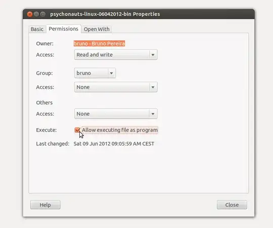

Has an option you can also open your Home Folder and navigate to Downloads, once there right click on the downloaded file and select properties
on the permissions tab make sure that the Execute option is set, if not do so and close.

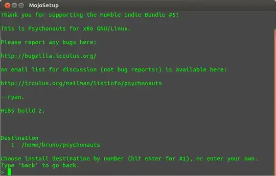

Now you can double click you file. The installer will pop-up
You can then install the game to the destination you chose and that should be all.
