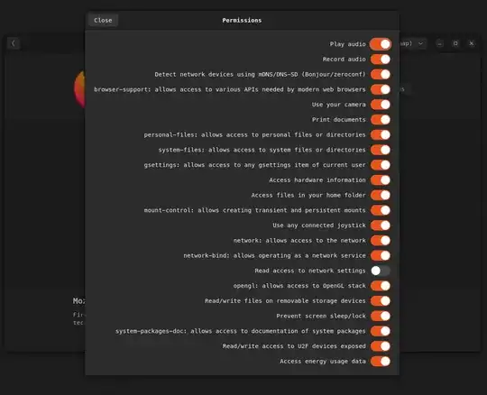

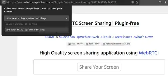

    • Webrtc screen sharing showing no option of windows we can share from the drop down menu. With the default option, when I click share nothing happens. WebRTC and Firefox permissions Look like this :

Following a comment from @Dan Eisenhut, recently I've updated Firefox and sharing screen via browser is confirmed to be working now. On the other hand, I've updated Zoom app as well and share screen showing just a black screen.
raisa_
  • 391
Yes, after initially having problems in a meeting where I needed it, I have now solved this by installing xdg-desktop-portal-gnome using:
sudo apt install xdg-desktop-portal-gnome
After that a restart is needed.
This is my setup:
  • Ubuntu 22.04.3 LTS
  • GNOME 42.9
  • Wayland
  • pipewire 0.3.48-1ubuntu3
  • xdg-desktop-portal 1.14.4-1ubuntu2
  • xdg-desktop-portal-gnome 42.1-0buntu1 (this is what was missing, I only had xdg-desktop-portal-gtk)
It works in Firefox web browser (FF 117.0.1) and desktop app (5.16.1).
