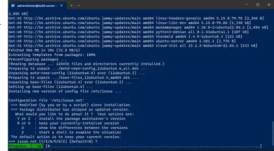

After some answers on the stackoverflow and some research on this forum I missed the DEBIAN_FRONTEND=noninteractive part So i tested with this command: sudo DEBIAN_FRONTEND=noninteractive apt upgrade -y but still witouth good results.
The problem i'm facing is that all my virtual machines have the sh config file edited with a /etc/issue.net included since this is a standard security practice founded on every information I could gather. Due to the fact that this file has been edited, while upgradeing the ssh-server package it asks what I want to do? Default it will take the local edited version but it requires the user to PRESS ENTER When trying the command above I still had to PRESS ENTER, however after the upgrade was done I discovered in the terminal NEEDRESTART DEBIAN_FRONTEND=noninteractive service.
So first: Is it possible after env variable change it need a restart to take affect? Due to the fact that the ssh package does not always have an upgrade available is there something I can do to test this?
And/or as last question Does the env variable not change the effect for the user input? I haven't tested my script on cron tab to see if it's is working or not due to the fact again that there is not always an upgrade available.
