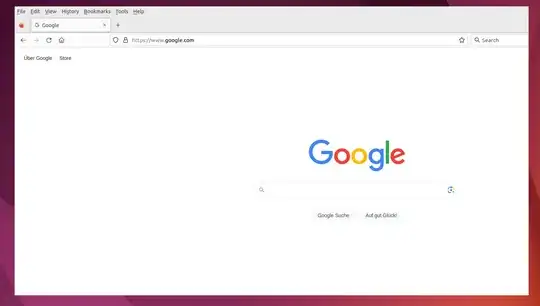

When trying to drag the window, at first it seems like it is stuck but dragging far enough will result in the window being "detached"/"unmaximized". I can now drag it as usual, but the window itself will keep its original "spacing/res". Please have a look at the picture.
dragged and then dropped browser window

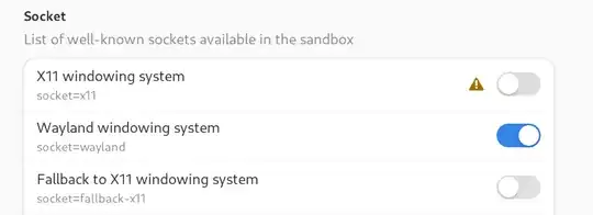

Solution for Flatpak Users
While I use the Flatpak version of Firefox (as opposed to your Snap version), the underlying cause might be similar. Here's how I addressed it using the Flatpak version:
  1. I installed and opened the 'Flatseal' application – a permissions manager for Flatpak applications.
  2. Inside Flatseal, I located the Firefox application settings.
  3. I disabled X11 support for Firefox.
A screenshot of the Flatseal configuration options.
After making this change and restarting Firefox, the 'Window Protocol' option in about:support showed wayland, confirming that Firefox was now running natively on Wayland. Additionally, the described issue disappeared.
Note: You might need to search for a similar setting or method if you're using the Snap version of Firefox.
