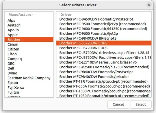

For completness: The driver reported by Gnome desktop is 'Brother MFC-J5720DW CUPS', despite the fact that the latest available Brother drivers are installed.

The printer is accessed via LAN. I have tried to install the latest drivers just when writing this. And figured out I still had the latest drivers already installed - there was no change. Yet in the GUI, when choosing the driver only those with CUPS in their name are offered.
