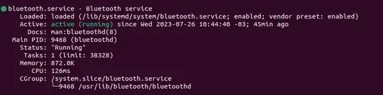

The service seems running (as shown in the image)
but the logs throw two errors:
jul 26 10:44:40 andy systemd[1]: Started Bluetooth service.
jul 26 10:44:40 andy bluetoothd[9468]: Starting SDP server
jul 26 10:44:40 andy bluetoothd[9468]: Bluetooth management interface 1.22 initialized
jul 26 10:44:40 andy bluetoothd[9468]: Failed to set mode: Not Supported (0x0c)
jul 26 10:44:40 andy bluetoothd[9468]: Endpoint registered: sender=:1.125 path=/MediaEndpoint/A2DPSink/sbc
jul 26 10:44:40 andy bluetoothd[9468]: Endpoint registered: sender=:1.125 path=/MediaEndpoint/A2DPSource/sbc
jul 26 10:44:40 andy bluetoothd[9468]: Endpoint registered: sender=:1.125 path=/MediaEndpoint/A2DPSink/sbc_xq_453
jul 26 10:44:40 andy bluetoothd[9468]: Endpoint registered: sender=:1.125 path=/MediaEndpoint/A2DPSource/sbc_xq_453
jul 26 10:44:40 andy bluetoothd[9468]: Endpoint registered: sender=:1.125 path=/MediaEndpoint/A2DPSink/sbc_xq_512
jul 26 10:44:40 andy bluetoothd[9468]: Endpoint registered: sender=:1.125 path=/MediaEndpoint/A2DPSource/sbc_xq_512
jul 26 10:44:40 andy bluetoothd[9468]: Endpoint registered: sender=:1.125 path=/MediaEndpoint/A2DPSink/sbc_xq_552
jul 26 10:44:40 andy bluetoothd[9468]: Endpoint registered: sender=:1.125 path=/MediaEndpoint/A2DPSource/sbc_xq_552
jul 26 10:45:14 andy bluetoothd[9468]: Failed to set mode: Authentication Failed (0x05)
jul 26 10:47:11 andy bluetoothd[9468]: Endpoint unregistered: sender=:1.125 path=/MediaEndpoint/A2DPSink/sbc
jul 26 10:47:11 andy bluetoothd[9468]: Endpoint unregistered: sender=:1.125 path=/MediaEndpoint/A2DPSource/sbc
jul 26 10:47:11 andy bluetoothd[9468]: Endpoint unregistered: sender=:1.125 path=/MediaEndpoint/A2DPSink/sbc_xq_453
jul 26 10:47:11 andy bluetoothd[9468]: Endpoint unregistered: sender=:1.125 path=/MediaEndpoint/A2DPSource/sbc_xq_453
jul 26 10:47:11 andy bluetoothd[9468]: Endpoint unregistered: sender=:1.125 path=/MediaEndpoint/A2DPSink/sbc_xq_512
jul 26 10:47:11 andy bluetoothd[9468]: Endpoint unregistered: sender=:1.125 path=/MediaEndpoint/A2DPSource/sbc_xq_512
jul 26 10:47:11 andy bluetoothd[9468]: Endpoint unregistered: sender=:1.125 path=/MediaEndpoint/A2DPSink/sbc_xq_552
jul 26 10:47:11 andy bluetoothd[9468]: Endpoint unregistered: sender=:1.125 path=/MediaEndpoint/A2DPSource/sbc_xq_552
jul 26 10:47:19 andy bluetoothd[9468]: Failed to set mode: Not Supported (0x0c)

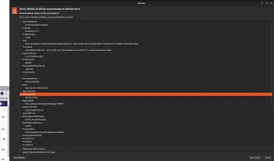

When I restart the service, a bluetooth error shows up:
