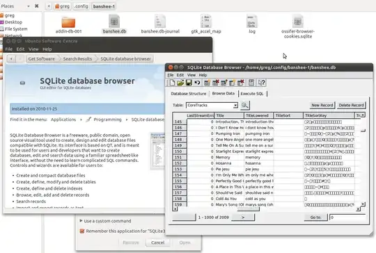

  1. From the Ubuntu Software Centre install the SQLite Data Browser
    sudo apt-get install sqlitebrowser
  2. Navigate to ~/.config/banshee-1 in the file browser (press Ctrl+H to toggle the viewing of hidden . files)
  3. Right click on banshee.db and click on Open With Other Application. From here open the Use a custom command box and enter sqlitebrowser
  4. From within the SQLite Data Browser then click on the Browse Data tab, and then click on the CoreTracks 'table'.
  5. From here scroll horizontally so you can see the track names. Once you've found a track scroll even further to the right until you find the PlayCount header. Double click on the current playcount, enter a new one, and press Apply Changes
Note: Banshee's developers have expressed some interest in implementing this from within Banshee, if you remind them they might jump into action...
Screenshot of various steps
