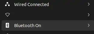

Network Manager:
Settings Dropdown status

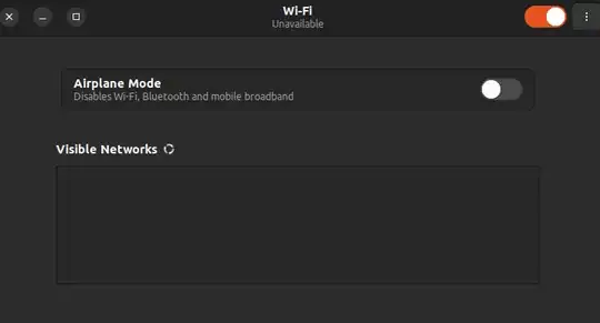

Wifi Settings:
Wifi settings window

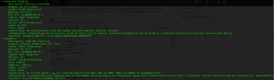

Results of lshw -class network:
Screenshot result lshw
Results of lspci:
screenshot result lspci

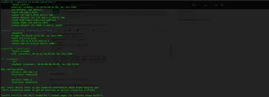

Results of nmcli:
Screenshot result nmcli
