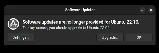

I was under the impression 22.10 was a LTS version of Ubuntu?

Nikolaj Hansen
  • 468
As you see here: https://wiki.ubuntu.com/Releases the last LTS version before 23.04 had been Ubuntu 22.04.2 LTS.
Heslacher
  • 111
It's not, did you read any release notes
https://fridge.ubuntu.com/2022/10/20/ubuntu-22-10-kinetic-kudu-released/
says rather clearly
Maintenance updates will be provided for 9 months for all flavours releasing with 22.10.
Which is why end of life warnings came out awhile ago
https://fridge.ubuntu.com/2023/06/14/ubuntu-22-10-kinetic-kudu-reaches-end-of-life-on-july-20-2023/
Ubuntu announced its 22.10 (Kinetic Kudu) release almost 9 months ago, on October 20, 2022, and its support period is now nearing its end. Ubuntu 22.10 will reach end of life on July 20, 2023.
and very soon, the final EOL notices will be out.
LTS releases are the first release in an even year, ie. Ubuntu 22.04 LTS was the 2022-April LTS release.
