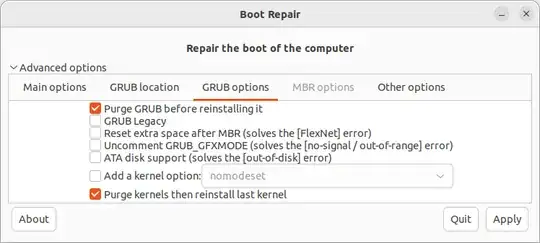

  1. choose advanced options in boot-repair
  2. in grub options choose purge kernels then reibstall last kernel
