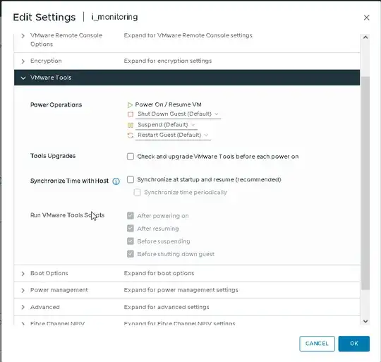

Solution
As my VPS server hosted on VMWARE ESXI OS, and find a similar topics about time conflict I try to disable this feature.
Finally after many tries I find error source and resolve it.
Disable sync time on startup
EsmaeelE
  • 425
  • 16
