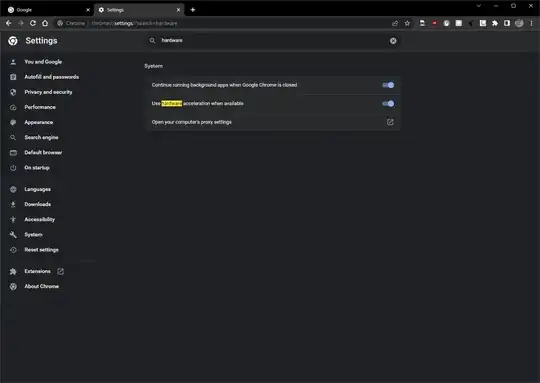

Try doing the GPU thing first from the other answer. If it fails, then try what I have below. Thank you!
Try either enabling or disabling "Use hardware acceleration when available" in Google Chrome settings.
Hope this helps!
