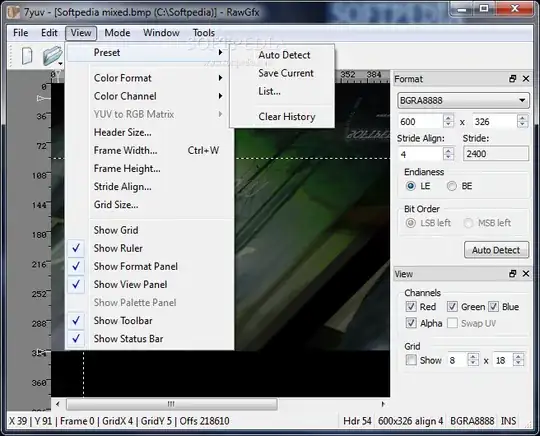

I have a raw file but I don't know the pixel format or the width of the image. I need a tool that can quickly display the data and allow me to try different formats easily. An example of such a tool for Windows would be 7yuv. What software exists for this task on Linux?
Note: This has nothing to do with digital camera raws, which is frustrating my attempts to use Google to answer this question.
7yuv

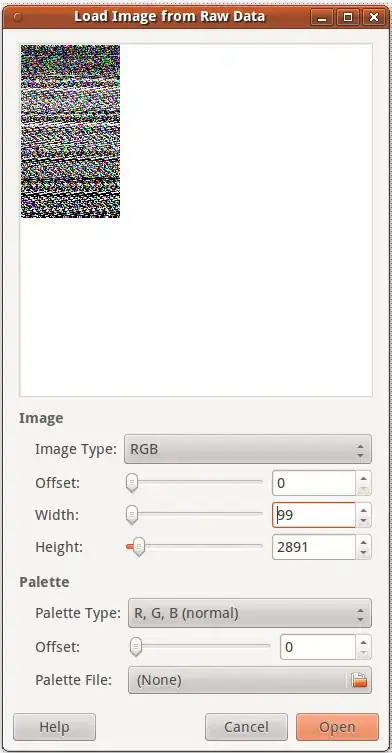

Turns out Gimp can do this. Just open the file as raw, and you get this helpful dialog that allows you to preview the image:

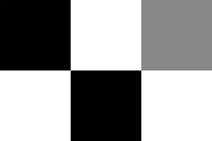

E.g., an 8-bit 2x3 grayscale:
printf '\x00\xFF\x88\xFF\x00\xFF' > in.bin
Then:
convert -depth 8 -size 3x2+0 gray:in.bin out.png
Output (once you scale it up somehow, see section below for details):

How to view such tiny outputs like this example
The problem now is how to view the such a tiny 3x2 output accurately. A direct eog:
is not very good because the image is too small, and if you zoom in a lot eog uses a display algorithm that mixes up pixels continuously, which is better for most pictures, but not for such a tiny image.
One good possibility is to run:
or directly in one go with:
convert -depth 8 -size 3x2+0 gray:in.bin -scale 300x out.png
-scale is needed instead of -resize, since -resize mixes pixel colors continuously up much like eog by default.

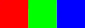

RGB example
printf '\xFF\x00\x00\x00\xFF\x00\x00\x00\xFF' > in.bin
convert -depth 8 -size 3x1+0 rgb:in.bin out.png
or with the -scale to make it more viewable:
convert -depth 8 -size 3x1+0 rgb:in.bin -scale 300x out.png
