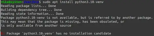

But, python3.10-venv didn't.

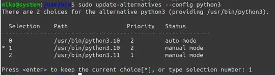

Than I've tried to switch versions and try install python3.10-venv again, working under python3.10, and looks like they have been switched.
But, with python3.10 i have not-working package manager
(looks like python3.11 is used in 23.04 system components).

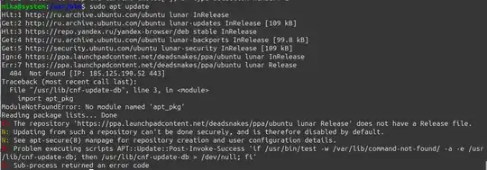

I've tried to sudo add-apt-repository ppa:deadsnakes/ppa, working under python3.11 (bc apt doesn't work with python3.10 in current situation), but soon i realised,
that deadsnakes doesn't support Ubuntu 23.04 for now.
