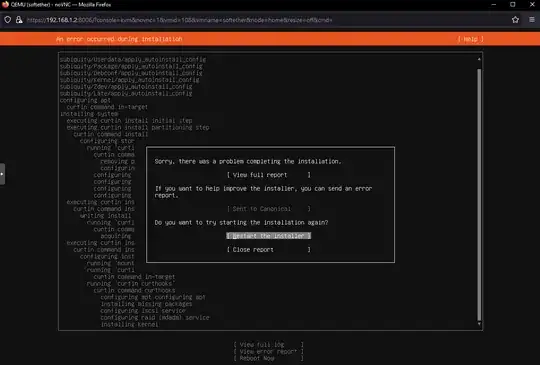

I'm trying to install Ubuntu 22.04-server on my Proxmox 7.4-3 machine. I've downloaded the ISO several times and checked the checksum, so I'm reasonably certain everything is fine with that. I've also noticed any 20.04 image I have running and working suddenly starts to kernel panic when it tries to boot after I use do-release-upgrade to upgrade it to 22.04.
Here's the error I'm getting: ubuntu error

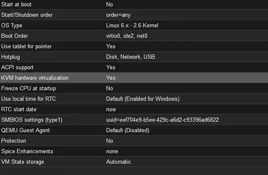

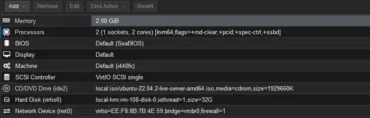

I'm kind of new to proxmox, so I'm not sure what I'm doing wrong. Are these settings helpful? What else can I provide that's helpful to solving this? settings1 settings2

I figured out the answer for this. I had to change the BIOS on proxmox to the UEFI bios option. Apparently that's become mandatory for 22.04. My ISO seems to boot and properly install now.
