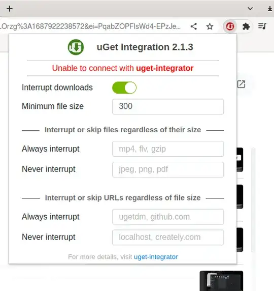

If you're facing the same issues then do follow my steps!
  • Open Chrome Web Store and search for uget uGet Integration
  • After adding this extension you must enable it. You can see this picture.
uget extension
  • Go to this link, then open the terminal and type:
sudo add-apt-repository ppa:uget-team/ppa
sudo apt update
sudo apt install uget-integrator
After following these steps open Google Chrome, then open Extensions -> Manage extensions -> uGet integration details -> enable Allow access to file URLs
