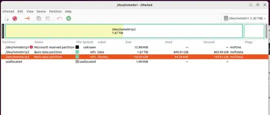

Here is my data drive and its partitions (I'm running Ubuntu Live right now so I can get this sorted):
The partition labeled "Ubuntu" is the shrunk partition I originally planned to install Ubuntu on. "Data" is all of my personal data from Windows (If this partition gets messed up, I am royally F'd.)
