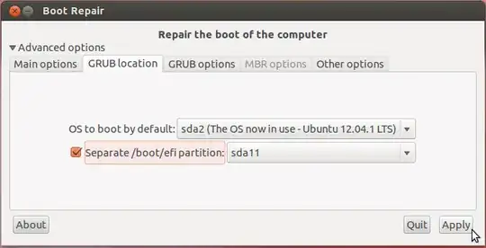

In this windows click "Advanced options"
Then click "GRUB location"
Choose "Place GRUB into:
In the drop down box opposite the last selection choose your HDD rather than your USB drive. On my computer my HDD is named "sda" and the USB drive "sdb" but these may be the other way around for you, or even different things if you have an unusual drive set up.

fdisk can't repair GRUB, it was suggested only to help you choose the right drive. The Boot-Repair utility wants you to check its settings and enable correct repair options. It could do this automatically, but it's safer (in theory!) to allow this choice to the user.
So, assuming you have UEFI instead of BIOS, you have first to create an EFI partition then select it in Boot-Repair:
Refer to this guide if you have other problems.
