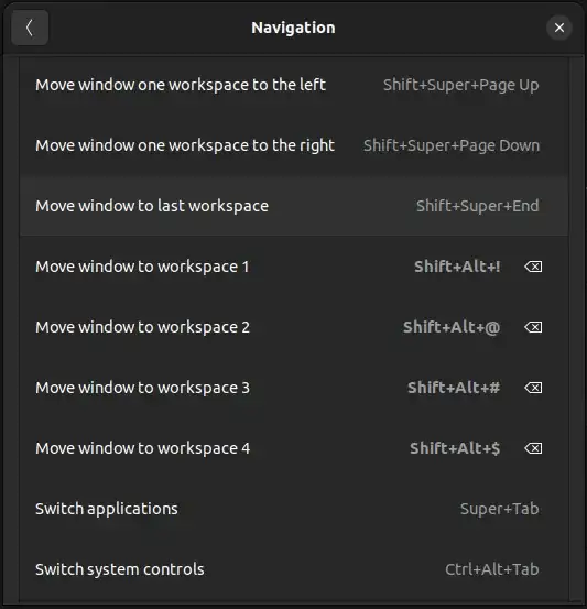

EDIT 2023-06-25: Here is a screenshot of the relevant shortcuts in Gnome settings showing that Shift+Alt+$ is bound to "Move window to workspace 4" as intended. As mentioned above, the similar shortcuts for workspaces 1-3 work fine (as well as the ones for workspaces 5-6 that I set up on the command line) but the one for workspace 4 does nothing.
screenshot of workspace navigation keyboard shortcut settings showing that "Move window to workspace 4" is bound to Shift+Alt+$
EDIT 2023-07-02: First, just to confirm that the keybindings really are set up correctly, here is an excerpt from dconf dump /:
move-to-workspace-1=['<Shift><Alt>exclam']
move-to-workspace-2=['<Shift><Alt>at']
move-to-workspace-3=['<Shift><Alt>numbersign']
move-to-workspace-4=['<Shift><Alt>dollar']
move-to-workspace-5=['<Shift><Alt>5']
move-to-workspace-6=['<Shift><Alt>6']
Again, all of these work except for the fourth one.
