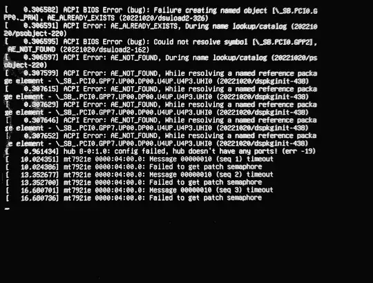

UPD: I found something interesting, but doesn't know what to do with it.
Here are some details about the system and the error:

arthur@rog:~$ lspci -knn | grep Net -A3 04:00.0 Network controller [0280]: MEDIATEK Corp. MT7922 802.11ax PCI Express Wireless Network Adapter [14c3:0616] Subsystem: Foxconn International, Inc. MT7922 802.11ax PCI Express Wireless Network Adapter [105b:e0df] Kernel driver in use: mt7921e Kernel modules: mt7921e 05:00.0 PCI bridge [0604]: ASMedia Technology Inc. Device [1b21:242a] (rev 01)
arthur@rog:~$ cat /var/log/syslog | grep mt7921e 2023-06-11T22:23:11.206338+03:00 rog kernel: [ 6.439473] mt7921e 0000:04:00.0: Message 00000010 (seq 1) timeout 2023-06-11T22:23:11.206358+03:00 rog kernel: [ 6.439485] mt7921e 0000:04:00.0: Failed to get patch semaphore 2023-06-11T22:23:14.534340+03:00 rog kernel: [ 9.767483] mt7921e 0000:04:00.0: Message 00000010 (seq 2) timeout 2023-06-11T22:23:14.534359+03:00 rog kernel: [ 9.767491] mt7921e 0000:04:00.0: Failed to get patch semaphore 2023-06-11T22:23:17.862322+03:00 rog kernel: [ 13.095794] mt7921e 0000:04:00.0: Message 00000010 (seq 3) timeout 2023-06-11T22:23:17.862340+03:00 rog kernel: [ 13.095801] mt7921e 0000:04:00.0: Failed to get patch semaphore 2023-06-11T22:23:21.190337+03:00 rog kernel: [ 16.423822] mt7921e 0000:04:00.0: Message 00000010 (seq 4) timeout 2023-06-11T22:23:21.190357+03:00 rog kernel: [ 16.423830] mt7921e 0000:04:00.0: Failed to get patch semaphore 2023-06-11T22:23:24.518309+03:00 rog kernel: [ 19.751474] mt7921e 0000:04:00.0: Message 00000010 (seq 5) timeout 2023-06-11T22:23:24.518325+03:00 rog kernel: [ 19.751485] mt7921e 0000:04:00.0: Failed to get patch semaphore 2023-06-11T22:23:27.846330+03:00 rog kernel: [ 23.079810] mt7921e 0000:04:00.0: Message 00000010 (seq 6) timeout 2023-06-11T22:23:27.846349+03:00 rog kernel: [ 23.079817] mt7921e 0000:04:00.0: Failed to get patch semaphore 2023-06-11T22:23:31.174293+03:00 rog kernel: [ 26.407472] mt7921e 0000:04:00.0: Message 00000010 (seq 7) timeout 2023-06-11T22:23:31.174300+03:00 rog kernel: [ 26.407483] mt7921e 0000:04:00.0: Failed to get patch semaphore 2023-06-11T22:23:34.502328+03:00 rog kernel: [ 29.735457] mt7921e 0000:04:00.0: Message 00000010 (seq 8) timeout 2023-06-11T22:23:34.502345+03:00 rog kernel: [ 29.735466] mt7921e 0000:04:00.0: Failed to get patch semaphore 2023-06-11T22:23:37.830332+03:00 rog kernel: [ 33.063486] mt7921e 0000:04:00.0: Message 00000010 (seq 9) timeout 2023-06-11T22:23:37.830351+03:00 rog kernel: [ 33.063498] mt7921e 0000:04:00.0: Failed to get patch semaphore 2023-06-11T22:23:41.158308+03:00 rog kernel: [ 36.391450] mt7921e 0000:04:00.0: Message 00000010 (seq 10) timeout 2023-06-11T22:23:41.158325+03:00 rog kernel: [ 36.391457] mt7921e 0000:04:00.0: Failed to get patch semaphore 2023-06-11T22:23:41.238297+03:00 rog kernel: [ 36.471989] mt7921e 0000:04:00.0: hardware init failed
