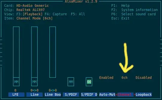

I tried all the answers. I even tried killing pulseaudio and rebooting the PC, but the issue came back after some time. What worked was changing the output channels from 2Channels in AlsaMixer to 6channels (even 4 channels didn't work).
  1. Type alsamixer in terminal.
  2. Select your card with F6.
  3. Go right in the sections with the right arrow. When you reach 'Channel' press up arrow and set it to 6Channels.
AlsaMixer:
alsamixer snapshot
