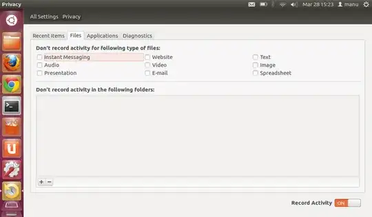

You can specify the kind of files whose activities you don't want to be recorded. Optionally, you can deselect specific folders from the watch-list.

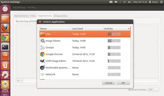

Same can be done for applications as well. You are allowed to manually select specific applications that you don't want to be recorded. As you can see, selecting applications has also been made easy since it comes sorted based on their daily activity by default.

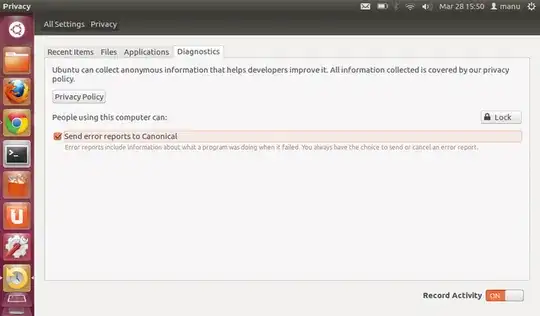

And then there is this diagnostics tool which when activated, lets your Ubuntu send anonymous information such as error reports to Canonical automatically. Also, this option is disabled by default.
