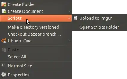

Nautilus Scripts
Nautilus scripts can be written in any programming language, including python. You just need to make your python source file executable and copy it to ~/.gnome2/nautilus-scripts in Ubuntu versions prior to 14.04. For Ubuntu 14.04 and newer the directory is different: ~/.local/share/nautilus/scripts
You will also need to add #!/usr/bin/env python as the first line of the file. Note that by default #!/usr/bin/env python points to Python2. If you need Python 3 specifically, use #!/usr/bin/env python3.
Once you have done all this, the script will be accessible from the scripts sub-menu of the right click menu in Nautilus.
nautilus scripts menu
See also:https://help.ubuntu.com/community/NautilusScriptsHowto
