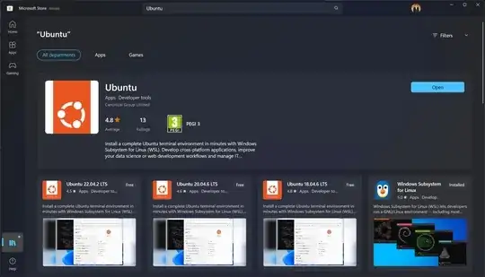

Go to the Microsoft Store and install any of the Ubuntu distributions:
Microsoft Store - Ubuntu Search

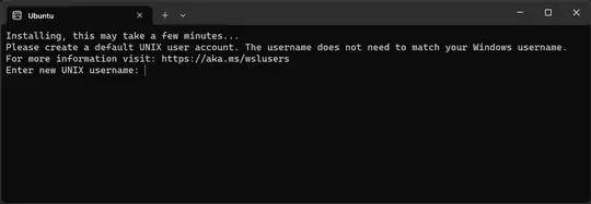

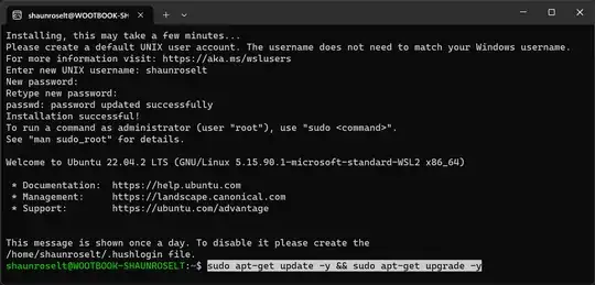

Once you've installed Ubuntu, you can click on the "Open" button and you should see a Terminal window popping up that says "Installing, this may take a few minutes..." and then allow you to set up a user account afterward: Ubuntu WSL Setup

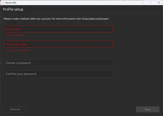

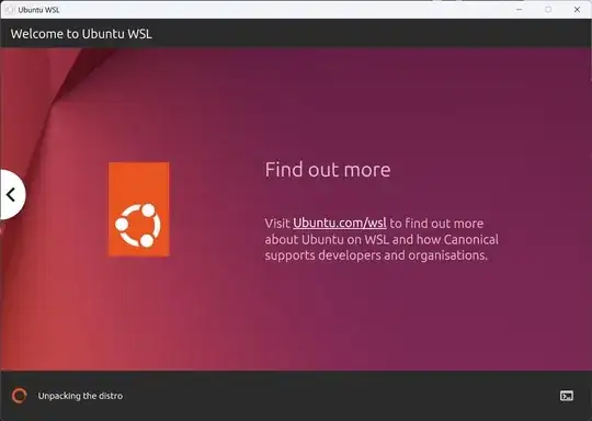

Some distributions might pop up a GUI window instead of the terminal. If a GUI opens, just continue and setup your account on the GUI:
Ubuntu WSL GUI
Ubuntu WSL GUI Profile Setup

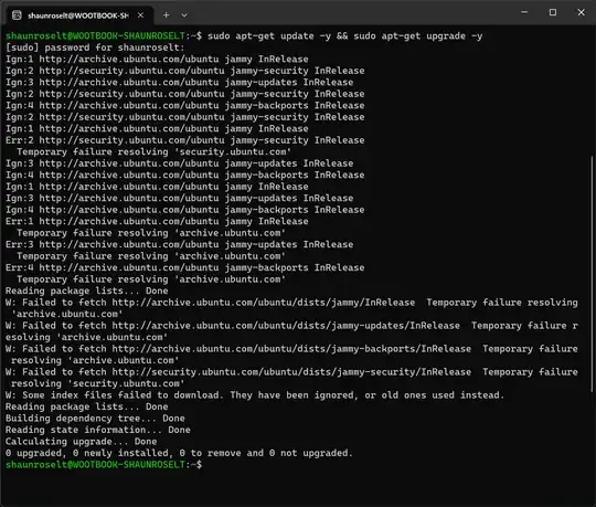

Once you're done with your account setup on Ubuntu, then your Ubuntu is finished setting up and you can start by making sure everything is up to date with the following commands in the terminal:
Update Ubuntu to latest version
sudo apt-get update -y && sudo apt-get upgrade -y
Updated Ubuntu packages

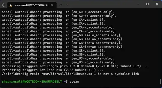

sudo apt-get install steam
Once it's finished installing, then you can open Steam by simply typing steam and it'll open the Linux version of Steam:

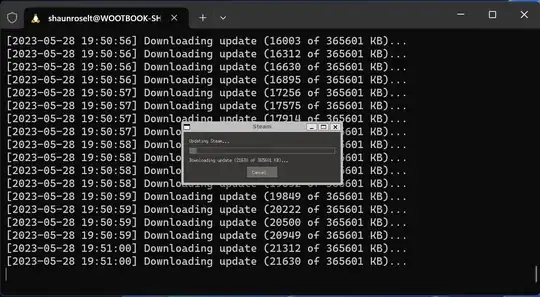

Open Steam from Ubuntu Terminal Steam Updating

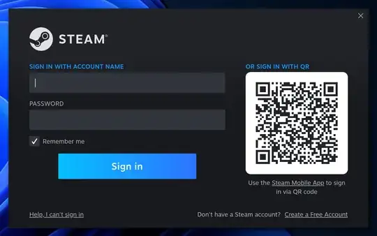

Steam will most likely have some updates to do first, but once the updates are done, then it'll open the Steam Client and you can sign into your Steam Account as normal: Steam
You can also see from these photos that it's definitely the Linux version of Steam:
Steam Client
