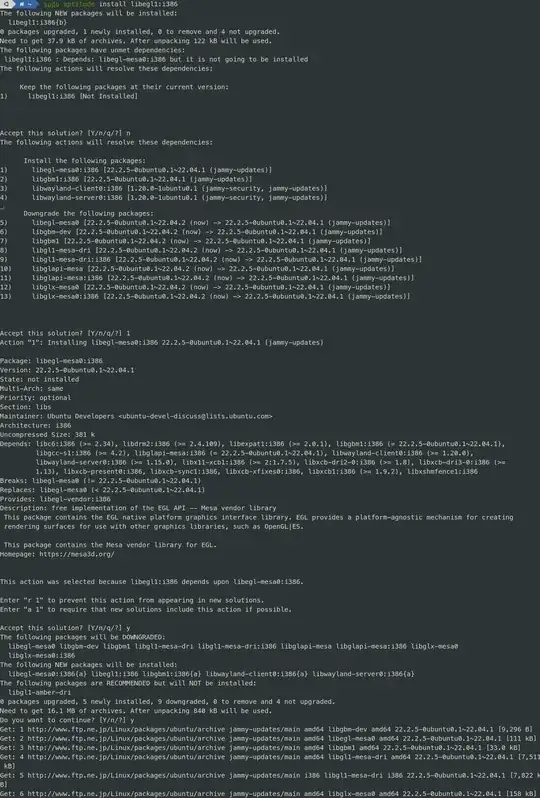

sudo aptitude install libegl1:i386
"aptitude" command will give you options of what available choices we can do to install this package, usually including downgrading other packages (image attached). "aptitude" can be very useful, but also please be careful to use it. I can't exactly give more input on what option number you should choose, because it will be different for each system. This is something that only trial & error can do.
Make sure all the packages that originally can't be installed are now all installed, do reboot (just to be safe), then try to install Steam again.
