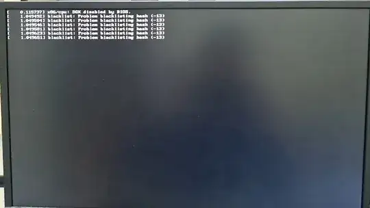

I am using:
  • Main B360M PRO-VH version bios 7B53v1C (2022-11-07)
  • SSD Samsung 970 EVO Plus PCIe NVMe VNAND M.2 2280

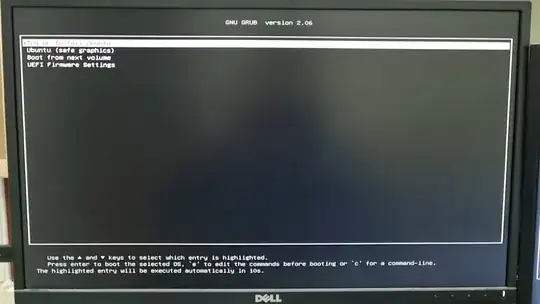

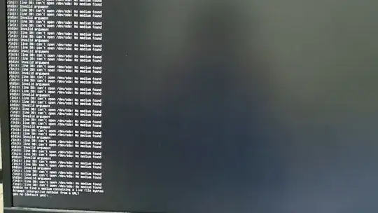

I install Ubuntu 23.04 desktop from the official website (https://ubuntu.com/download/desktop) from usb boot but the system notifies errors. I try to change more settings in the bios setting but it still error.
[RESOLVE] Edit 20h01 25/05/2023: My USB has a problem, I change another USB and then install successfully.
Update 12h59 25/05/2023:
  • I use Balena etcher, Rufus, Startup Disk Creator (ubuntu) to burn file iso to USB
Is there anybody know why and how to fix it?
Thanks for reading.
