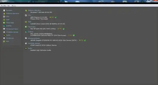

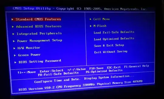

BIOS or UEFi?
I accessed the BIOS and not found a mention of UEFI (It is a low cost desktop PC from 2011).
Hardware? the motherboard is a MSI NF725M-P43
The SSD is Samsung M3 Portable 1TB
