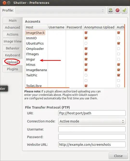

If you don't mind using a GUI:
shutter Install shutter is a feature-rich screenshot program. You can take a screenshot of a specific area, window, your whole screen, or even of a website – apply different effects to it, draw on it to highlight points, and then upload to an image hosting site, all within one window.
Edit > Preferences
Preferences dialog
