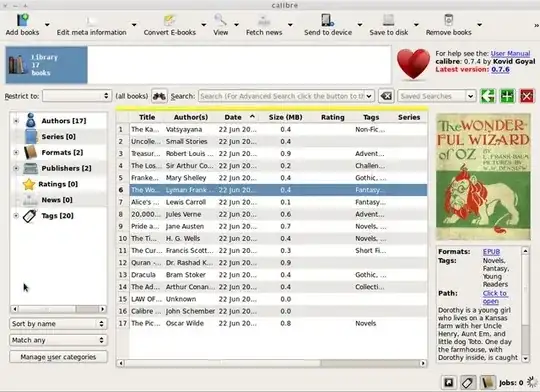

If the intent is to manage the book on your Kindle, what about using a native application like Calibre rather than the Kindle Windows software? Calibre is in the Ubuntu repositories so you can install it via the software centre or using the command line:
sudo apt-get install calibre

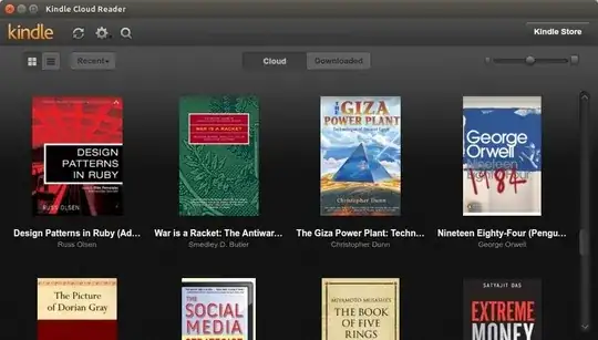

I've opted to make a native electron app using this method:
(you need to have nodejs installed)
  1. Open a terminal session and install Nativefier using this command:
    npm install nativefier -g
  2. cd into a directory you want your app installed into.
  3. run:
    nativefier "https://read.amazon.com" --name "Kindle" -p linux -a x64
Your output should resemble something like:
App built to /home/you/yourDirectory/Kindle-linux-x64
Right click and run the app. enjoy.
