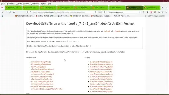

Go to Ubuntu package search, and search for the package you need there:
smartmontools for kinetic
In this case, you need smartmontools for Kinetic, and this can be downloaded from any of the mirrors listed.
Copy one hyperlink and then download the package with wget (here listed for http://mirrors.kernel.org/ubuntu/pool/main/s/smartmontools/smartmontools_7.3-1_amd64.deb):
wget -c http://mirrors.kernel.org/ubuntu/pool/main/s/smartmontools/smartmontools_7.3-1_amd64.deb
And finally you can install the downloaded deb with apt or dpkg:
sudo apt install ./smartmontools_7.3-1_amd64.deb
