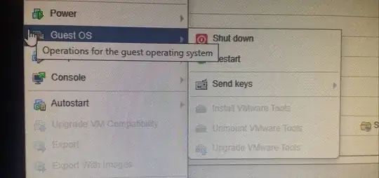

I have an ubuntu vm on VMware ESXi, When I try to install VMware tools it is grayed out, I make sure it is not installed.
Note: I install Ubuntu server 23.04 from USB stick.
Also there no internet connection
It is easier and better to install open-vm-tools from the Ubuntu repositories. Just open a virtual console to your VM and sudo apt update && sudo apt -y install open-vm-tools to use the operating system managed vmtools instead.
See https://kb.vmware.com/s/article/2073803 for more.
