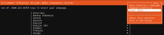

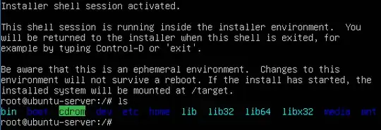

Boot up with the live server ISO image, you can choose "Enter shell" from the [Help] menu on top-right:
This is about as much as you'll get on a fully installed Ubuntu Server system. No desktop, no GUI, and a shell right away (except on an installed system you'll have to log in with your username and password). This environment comes with a minimal set for installing Ubuntu Server, and additional software can be installed online as usual with apt install.
This is also useful as a recovery environment to repair or modify an offline Ubuntu Server system, although I personally prefer ArchISO for this purpose.
