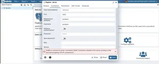

I have postgres 13.10 and PGAdmin4 7.1 installed on Ubuntu 22.04
In PGAdmin4 UI, I want to "add new server" with these configurations
name
postgres-local
username postgres
pw postgres
hostanme / address 127.0.0.1
port 5432
server group Servers
so I have run in my terminal
sudo -i -u postgres
psql
ALTER USER postgres WITH PASSWORD 'postgres';
Then I login into PGAdmin4, try to add new server inserting the cofigurations above, but as I click on save I get this error
unable to connect to server: connection failed: connection refused is the server running on that host accepting tcp/ip connections?
What could be the problem?

Have you made sure that postgres is running on that port?
sudo netstat -lntp | grep postgres
Have you made sure that the firewall is not blocking that port?
sudo ufw allow 5432
