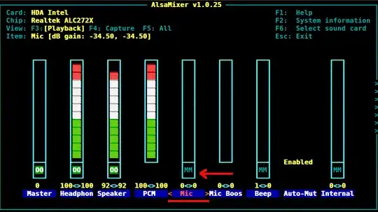

Blacklist the webcam driver and mute the Internal Mic from Alsamixer.
According to the informations you gave here, open a terminal and execute this command
Disable WebCam
echo 'blacklist webcamstudio' | sudo tee -a /etc/modprobe.d/blacklist.conf
Mute the microphone
To mute the internal microphone use the alsamixer.
Open a terminal and give this command
alsamixer
Navigate with arrow keys <--> and find the internal or mic channel and then press the M key on your keyboard to disable - mute [MM] the microphone. Esc to exit

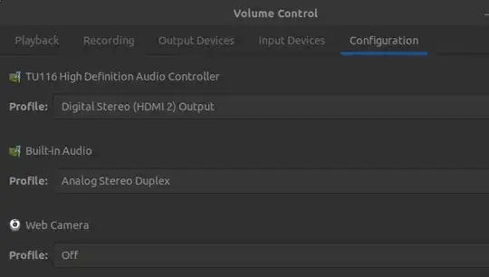

Use PulseAudio Volume Control (which has a GUI):
  • install pavucontrol via terminal (e.g. snap install pavucontrol or sudo apt install pavucontrol)
  • launch the tool via terminal or via launcher PulseAudio Volume Control
  • Go to the "Configuration" tab (you might need to resize the window to see it)
  • Disable the microphone by switching it to Off
This also worked for me after plugging in the webcam again (it's still switched off).
