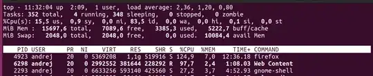

I have a completely new Ubuntu install with Firefox. When browsing on my usual sites, I get over 100% CPU usage due to the process "isolate+". Google has been completely useless. I have tried to disable hardware acceleration in Firefox, I have uninstalled the snap version and installed the .deb version. The only extension I have is ublock.
Ubuntu 22.04. Thinkpad T16, 16GB RAM, i7 1260P, NVidia MX550 (driver=nouveau)
This problem does not exist when I boot into Windows with the same device. (dual boot)
Edit: The easiest way to reproduce this behaviour is to try lection 45 of "typing jungle (UK)" on edclub.com. (I'm trying to learn a new keyboard layout...).

Assuming you are seeing this in the top command interactive screen output in the terminal, the + sign means the string is shortened to fit in the current terminal window ... Expanding/maximizing the terminals window should reveal the rest of the process's command name string as Isolated Web Co which should actually be Isolated Web Content but the characters excess of 15 are disposed off as a result of the limit for the command field in /proc/{PID}/stat.
This is related to the new Firefox’s Site Isolation feature AKA Project Fission which seems to be enabled by default in the late versions of Firefox ... It involves using/utilizing GFX WebRender(a GPU-based 2D rendering engine) which relies on system driver/support for your GPU ... If you experience issues from that, then it's most likely a GPU driver/setting issue and you need to either update/change the driver to a more stable/tested/better one(if available) or change the GPU driver settings if that is an option e.g. NVIDIA optimus/hybrid cards to select a single active GPU for example.
Disabling this safety feature is not recommended for pure safety fail-safe reasons.
This feature, however, can be disabled in Firefox's configuration tab(about:config) by setting both the fission.autostart and gfx.webrender.all options to false and restarting Firefox afterwards.

I had the same problem with Firefox 124.0.1 on Ubuntu 20.04. 'Isolated Web Co' process sometimes took 100%-250% CPU usage. The problem appeared more often:
  • When more than one window of Firefox were opened
  • After waking up a laptop from sleep
The problem was fixed in Firefox with version 125.0.1. Sometimes the similar behavior appears but it is possible to fix it without Firefox restarting:
  • The current Firefox page should be refreshed (F5),
  • or just new tab should be opened.
about:processes - this is Process Manager for Firefox tabs but it does not actually shows that some page is taking too much resources.
