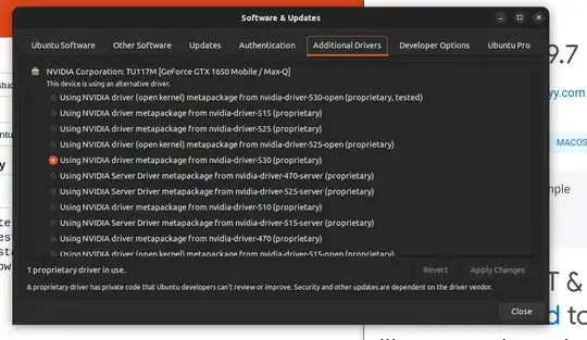

I also tried the GUI way to install a driver and get the strangest output

Note: There are comments related to my original question but I thought I would add how I got it installed because it's not exactly how other answers show how to do it on my Lenovo Gaming Laptop with GEFORCE GTX 1650 (Max-Q laptop version)
Choose this driver:
driver
at this point command nvidia-smi should work.
Download Cuda 12.1 run version from here: https://developer.nvidia.com/cuda-downloads
Note: if you previously tried to install and try to install again following instructions on that page and get "it is encouraged that you delete/remove...", I actually just said continue rather than abort and it then asks you whether you want to update the installation which I said yes to. Also don't forget to uncheck the driver using space bar since step 1 above you already have an Nvidia driver.
