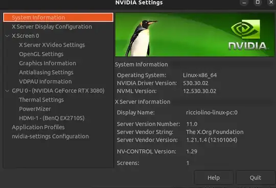

But still PRIME profiles tab is missing in the GUI app: enter image description here

Hi to all with similar problem!
Same issue here on Ubuntu Studio 22.04.
Be aware: I found a solution but it is somewhat pointless as older drivers (that you are going to install) just activate the "Performance Mode" if you choose "on-demand". At least a little popup tells you that if you choose this option via X-Server GUI.
Nevertheless:
After installing CUDA drivers the option “Prime Profiles” was not available / not showing. The only solution that helped me was given in this discussion:
List all nvidia versions available in the repositories you have added with
apt policy nvidia-settings
Then install the one that was shipped with your ubuntu version with command
sudo apt install nvidia-settings=VERSION_FROM_UBUNTU
As I wrote it will bring back the option "on-demand" to your GUI but it is rather senseless.
Have nice day!
ThomZen
