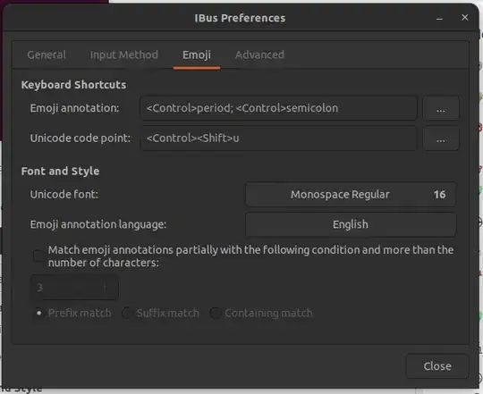

However, it seems they changed the default to Ctrl + . and Ctrl + ; recently. This is confirmed in my 22.04 machine when we look at ibus-setup (note I run my system theme in Dark Mode, which is why everything is dark on my screen):
You can simply change this with ibus-setup (execute this on the command line and it opens up the iBus Preferences window) and change the keyboard shortcut. Nothing's broken but a change was made. This is likely in the GNOME upstream changelogs somewhere, or was a change decided upon by Ubuntu.
In either case, this is readily fixable and not a bug nor "broken". Changed defaults are not a "breakage" in anything.
