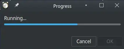

but just using zenity --progress --percentage=1 shows no real progress, the only useful option seems to be to use --pulsate, which at least shows something is happening with a line that goes back and forth.
ffmpeg -ss "$START" -t "$OFFSET" -i "$INPUT" -c copy "$OUTPUT" | zenity --width=400 --progress --pulsate --text="Running" --percentage=1 --auto-close --auto-kill
Trying to mimic this answer I do get a progress bar, but that is shown after the process has ended and the progress itself has nothing to do with the real process.
$(ffmpeg -ss "$START" -t "$OFFSET" -i "$INPUT" -c copy "$OUTPUT")
(for i in $(seq 0 3 100); do echo "$i"; sleep 0.1; done) | zenity --progress --width=400

I get a progress bar but the progress bar is shown before the actual process takes place.
The question is:
How to have something like in the image above, but synchronized in real time with the actual ffmpeg process?

I only use ffmpeg when I need to and that's it as far as my experience with it goes, so take that part with a pinch of salt ... So, I looked into it and noticed some output that looks like time=00:00:00:0.0 and figured out that it can be used for your purpose.
This is going to be ugly ... However, consider it a template or a boiler plate.
Using your $DIFF(needs to be in seconds only like e.g. 130 and not in full time format like 00:02:10) variable (Progress bar only)
ffmpeg -ss "$START" -t "$OFFSET" -i "$INPUT" -c copy "$OUTPUT" 2>&1 |
grep --line-buffered -Po "(?<=time=)[0-9:.]*" |
while read -r line; do echo "$line" |
awk -v offset="$DIFF" -F: 't=($1 * 3600) + ($2 * 60) + $3 {print t / offset * 100}'; done |
zenity --progress
... and with the text output as well
while read -r line; do grep -Po "(?<=time=)[0-9:.]*" <<<"$line" |
awk -v offset="$DIFF" -F: 't=($1 * 3600) + ($2 * 60) + $3 {print t / offset * 100}'; echo "# $line"; done |
zenity --progress --width="500"

Technical notice ffmpeg seems to act differently regarding the above mentioned output i.e. time=00:00:00:0.0 which it seams to print in some interactive(auto-updating) form that is being held until the end of the process when the output is being piped ... It, however, seems to be immediately sent through the pipe when there are other printed messages (warnings, info, errors ... etc.) as these seem to force flushing the standard streams buffers ... Therefore, increasing the -loglevel to trace seems to do the trick and force real-time status bar ... This, however, will need tuning if in addition you want to show the output as well in the zenity window as you'll need to do some messages filtering (those trace messages contain all sorts of output including numbers which will mess up the accuracy of the status bar).
