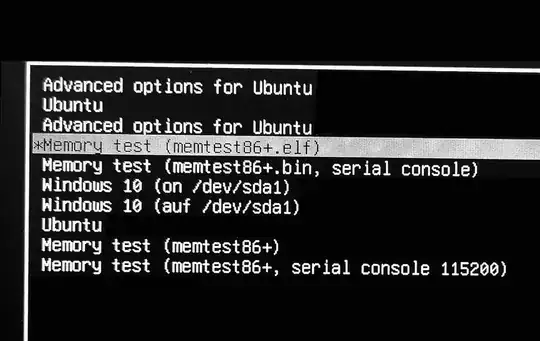

I want to clean up the entries in GRUB on Ubuntu 22.04 since there are a lot of duplicates:
Here's a screenshot of the GRUB menu:
photo of screen showing GRUB menu
Everything seems to be listed twice.
I already ran apt-get autoremove --purge, but there was nothing to remove. Here's the output of update-grub2:

Can someone tell me where these duplicates come from and how I get rid of them?

I had the same problem and I solved it using Grub-customizer.
I launched grub-customizer and in the list provided (I have 4 Linux distros (debian, ubuntu, mint and elementary), I moved all the main entries to the top and deleted everything else. After reboot the boot menu now shows only my four distros.
