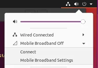

I then tried plugging the modem into an Ubuntu 20.04 VM (using gnome-boxes) and it works without any issues, besides seeing the device being registered with dmesg, I see this when executing nmcli dev:
enp1s0    ethernet  connected     Wired connection 1
cdc-wdm0  gsm       disconnected  --
lo        loopback  unmanaged     --
So you can see there that the cdc-wdm0 is visible and also I can see the device here: enter image description here
And I can just click connect, and I'm all set
