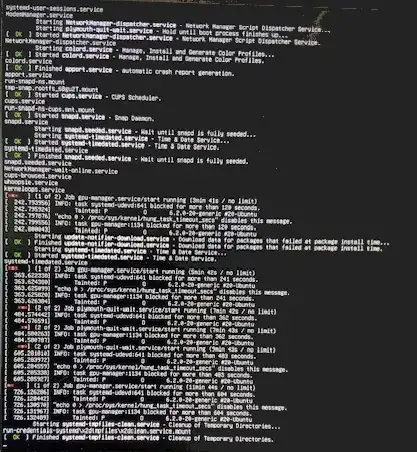

After upgrading from Ubuntu 22.10 to Ubuntu 23.04, the boot gets stuck on 2 processes:
  1. Job gpu-manager.service/start
  2. Job plymouth-quit-wait.service/start

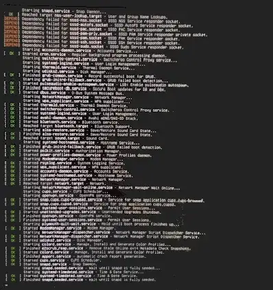

Also earlier in the boot shows "Dependency failed for" a series of SSSD services.
The computer is an Acer Predator Helios with a SSD. What should I do to fix it?
