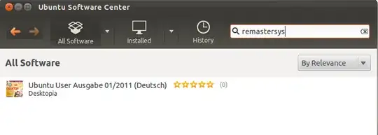

Searching for Remastersys in Software Center also doesn't give proper results:
remastersys search on USC
