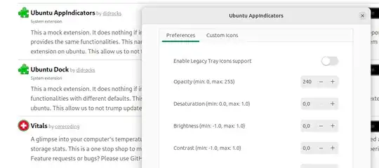

Mine solved by disabling Enable legacy tray icon support of App Indicator
