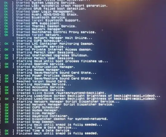

I recently powered on my computer after two weeks of vacation, and Ubuntu seemed to work fine. I did not install any new programs or make any config changes.
I rebooted the computer after about an hour of use. It loads the initial boot menu, and then it goes to the GRUB menu where I can select Ubuntu or Ubuntu with advanced options. After that, it just displays the above screen and then moves on to a blank screen with a blinking cursor.
I tried using this Boot Repair Tool as described in this post in order to fix my Grub, as I thought this was a Grub bootloader problem however this did not fix the problem.
https://linuxconfig.org/ubuntu-22-04-not-booting-troubleshooting-guide
At this point I'm honestly exhausted and completely out of ideas. I REALLY do not want to reinstall Ubuntu completely because it was such a pain to set up properly the first time. I'm thinking of just switching to a windows OS because I seem to run into an issue every month that takes half my day to solve with Ubuntu. Any ideas on troubleshooting are very much appreciated.
