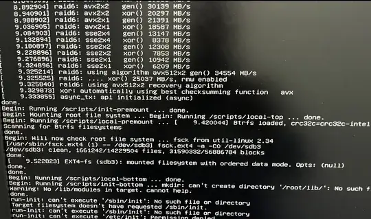

Some team in my company messed up with the /lib directory and rebooted the server. As a result, the following error is presented.
As a result, I booted up from a live usb-key to an Ubuntu desktop version to try and fix the issue and to avoid a clean install process.
What shall I do next to avoid reinstalling?
And assuming only that ... It appears from the error messages that the whole /lib/ directory is either not present or it is severely damaged.
